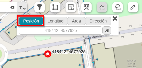

Position: to get the position of a point, access the Position option from the measurement buttons. When you click on any point on the map, the corresponding coordinates will be shown.
../../../../_images/posicion.png
Fig. 2 Obtaining point coordinates on the map.

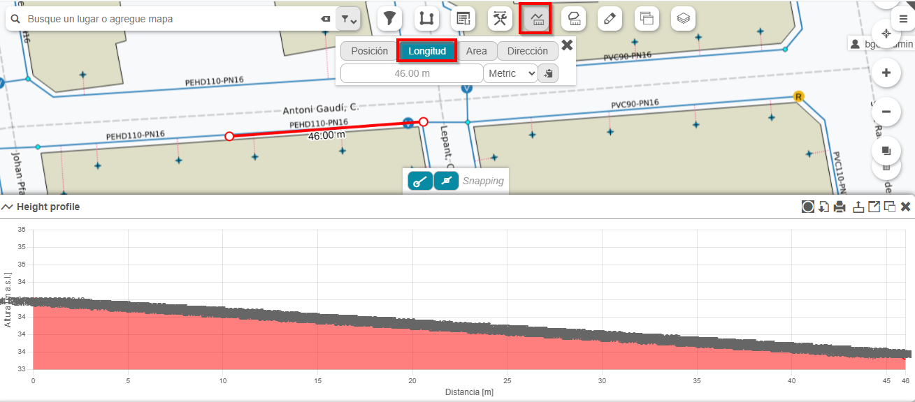

Length: once the tool is selected, activate the Length mode. Then, click on the map points between which you want to obtain the distance. The measurement units can be configured according to the project’s requirements. After defining the segment, the generated elevation profile will be shown at the bottom.
../../../../_images/medicion.png
Fig. 3 Using the Measurement tool to calculate Length.

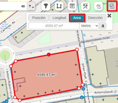

Area: to measure an area, you must select the Area mode from the measurement tool or directly from its button. Then, the polygon vertices are defined by clicking the corresponding points on the map. Once the polygon is closed, the calculated surface will be displayed.
../../../../_images/area.png
Fig. 4 Calculated area for a given polygon.

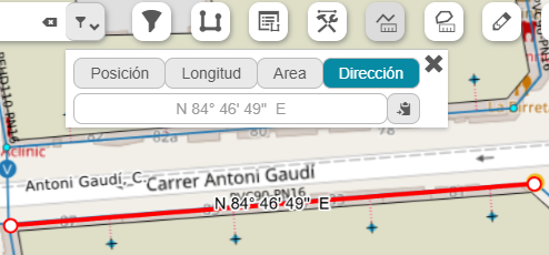

Direction: select the Direction option from the measurement buttons. Then click on two map points that define the direction to analyze. The system will calculate the corresponding azimuth between both points.
../../../../_images/direccion.png
Fig. 5 Calculation of bearing or azimuth between two points.
